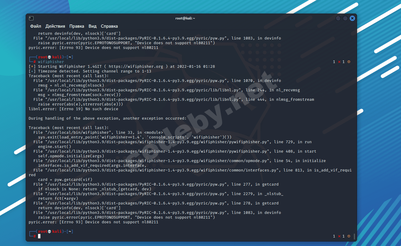

У меня крч ошибка выходит:
┌──(rootkali)-[~]
└─# wifiphisher                                                                                                                  1 ⨯ 1 ⚙
[*] Starting Wifiphisher 1.4GIT ( Wifiphisher - The Rogue Access Point Framework ) at 2022-01-16 01:28
[+] Timezone detected. Setting channel range to 1-13
  File "/usr/local/lib/python3.9/dist-packages/PyRIC-0.1.6.4-py3.9.egg/pyric/pyw.py", line 1070, in devinfo
    rmsg = nl.nl_recvmsg(nlsock)
  File "/usr/local/lib/python3.9/dist-packages/PyRIC-0.1.6.4-py3.9.egg/pyric/lib/libnl.py", line 244, in nl_recvmsg
    msg = nlmsg_fromstream(sock.recv())
  File "/usr/local/lib/python3.9/dist-packages/PyRIC-0.1.6.4-py3.9.egg/pyric/lib/libnl.py", line 444, in nlmsg_fromstream
    raise error(abs(e),strerror(abs(e)))
libnl.error: [Errno 19] No such device
During handling of the above exception, another exception occurred:
  File "/usr/local/bin/wifiphisher", line 33, in <module>
    sys.exit(load_entry_point('wifiphisher==1.4', 'console_scripts', 'wifiphisher')())
  File "/usr/local/lib/python3.9/dist-packages/wifiphisher-1.4-py3.9.egg/wifiphisher/pywifiphisher.py", line 729, in run
    engine.start()
  File "/usr/local/lib/python3.9/dist-packages/wifiphisher-1.4-py3.9.egg/wifiphisher/pywifiphisher.py", line 408, in start
    self.opmode.initialize(args)
  File "/usr/local/lib/python3.9/dist-packages/wifiphisher-1.4-py3.9.egg/wifiphisher/common/opmode.py", line 54, in initialize
    interfaces.is_add_vif_required(args.interface,
  File "/usr/local/lib/python3.9/dist-packages/wifiphisher-1.4-py3.9.egg/wifiphisher/common/interfaces.py", line 813, in is_add_vif_required
    card = pyw.getcard(vif)
  File "/usr/local/lib/python3.9/dist-packages/PyRIC-0.1.6.4-py3.9.egg/pyric/pyw.py", line 277, in getcard
    if nlsock is None: return _nlstub_(getcard, dev)
  File "/usr/local/lib/python3.9/dist-packages/PyRIC-0.1.6.4-py3.9.egg/pyric/pyw.py", line 2279, in _nlstub_
    return fct(*argv)
  File "/usr/local/lib/python3.9/dist-packages/PyRIC-0.1.6.4-py3.9.egg/pyric/pyw.py", line 278, in getcard
    return devinfo(dev, nlsock)['card']
  File "/usr/local/lib/python3.9/dist-packages/PyRIC-0.1.6.4-py3.9.egg/pyric/pyw.py", line 1083, in devinfo
    raise pyric.error(pyric.EPROTONOSUPPORT, "Device does not support nl80211")
pyric.error: [Errno 93] Device does not support nl80211
вот скрин
Ошибка намекает, что не поддерживается адаптер. Что за девайс?

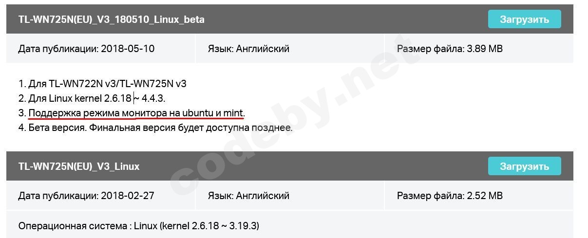

походу вот полное название​
Wi-Fi адаптер TP-LINK TL-WN725N просто по изображению похоже :D
а версия?
попробуй другие дрова поставить.
Твой вайфай адаптер дожен поддерживать режим монитора, и вообще с виртуальной машиной очень много гемора лучше такими делами заниматься на нормальнй ОС а не на симуляции
